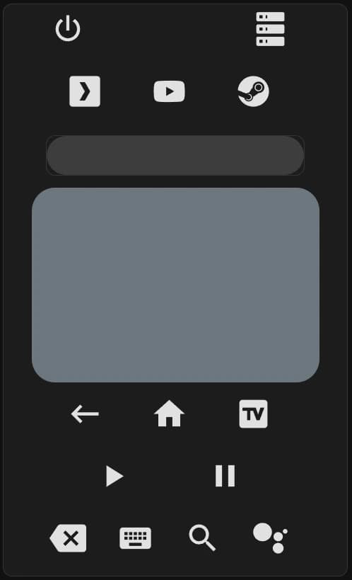

Card Configuration Example
Custom Card
type: custom:android-tv-card
remote_id: remote.android_tv
media_player_id: media_player.android_tv
power_row:
  - power
  - null
  - null
  - turn_on_server
apps_row:
  - plex
  - youtube
  - steam
volume_row: slider
navigation_row: touchpad
source_row:
  - back
  - home
Custom Source

Send Text Example
Put the keyboard button at the top of your card so that your screen does not shift to keep it in focus when the on screen keyboard opens.
Seamless Text Entry
Custom Card
adb_id: media_player.android_tv_ip
text_row:
  - keyboard
  - search
Bulk Text Entry
Custom Card
text_row:
  - delete
  - textbox
  - enter
Android-TV
Android-TV
tv
media_control_row:
- rewind
- play
- pause
- fast_forward
custom_sources:
steam:
icon: mdi:steam
source: steamlink://
custom_keys:
turn_on_server:
icon: mdi:server
service: switch.turn_on
service_data:
entity_id: switch.server
