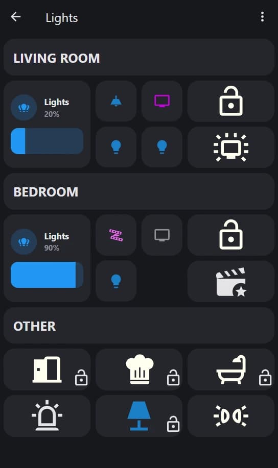

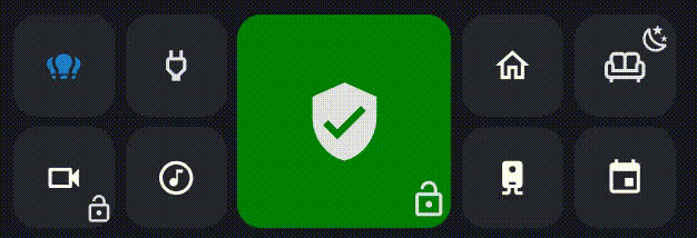

Security Card Template Example
Security Card
type: custom:button-card
aspect_ratio: 1/1
color_type: card
tap_action:
  action: call-service
  service: input_boolean.toggle
  service_data:
    entity_id: input_boolean.segurity
entity: input_boolean.intruder_alert
show_name: false
hold_action:
  service: input_boolean.turn_off
  service_data:
    entity_id: input_boolean.intruder_alert
state
Timer Bar Card Example
Timer Bar Card
type: custom:timer-bar-card
entity: timer.livingroom_timer
mushroom:
  color: blue
Area Button Card Example
Area Button
icon: mdi:bed-empty
show_name: false
show_state: false
entity: light.bedroom_lights
tap_action:
  action: navigate
  navigation_path: bedroom
hold_action:
  service: script.turn_on
  service_data:
    entity_id: script.turnoff_bedroom
template: area
custom_fields:
  topLeft:

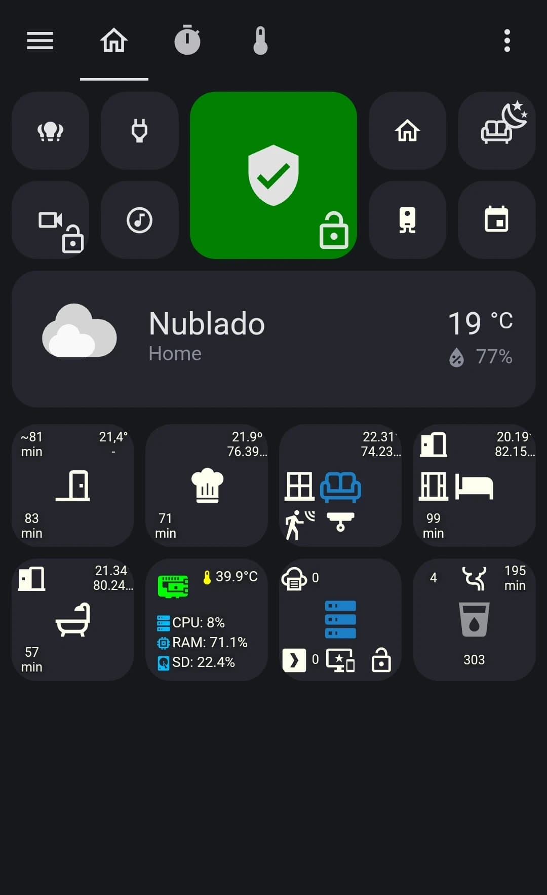

Movement 'Minutes Ago' Sensor Template
Sensor Template
sensor:
  - platform: template
    sensors:
      ## One For Each Device
      livingroom_on:
        friendly_name: LivingRoom minutes ago
        value_template: "{{ ((as_timestamp(now()) - as_timestamp(states.binary_sensor.livingroom_motion_sensor.last_changed)) / 60) | round(0) }}"
Title Markdown Example
Title Card
type: markdown
content: '## LIVING ROOM'

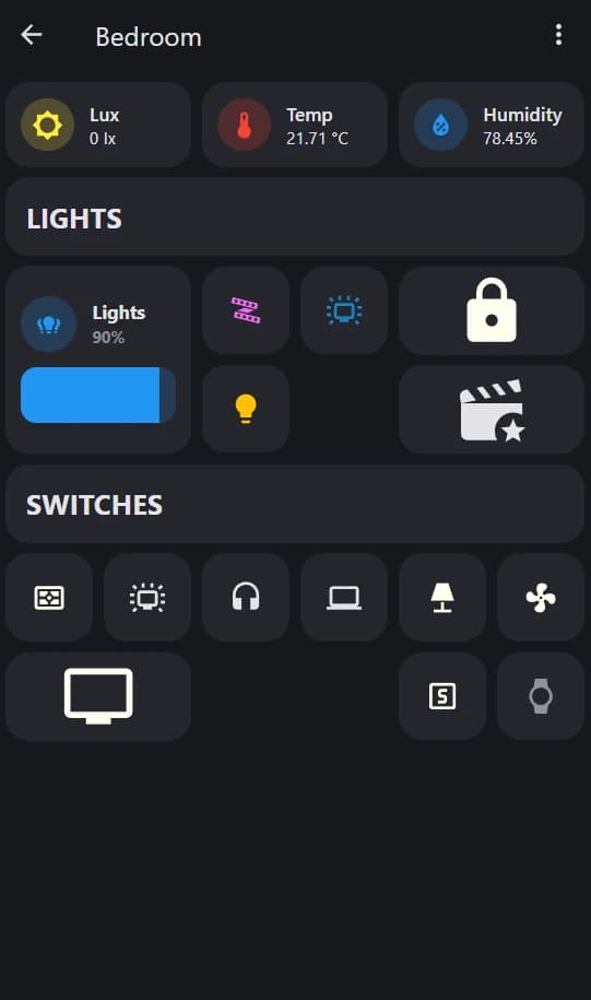

Mushroom Light Card Example
Mushroom Card
type: custom:mushroom-light-card
entity: light.living_room_lights
fill_container: true
use_light_color: false
show_brightness_control: true
show_color_temp_control: false
show_color_control: false
collapsible_controls: true
icon_color: blue
Bypass Button Card Example
Bypass Example
entity: light.lamp
icon: mdi:lamp-outline
show_name: false
tap_action:
  action: more-info
hold_action:
  service_data:
    entity_id: input_boolean.control_lamp
template: bypass
custom_fields:
  bypass: |
        if (states["input_boolean.control_lamp"].state === 'on') return `<ha-icon
          icon="mdi:lock"
          style="width: 30px; height: 30px; color: red;">
