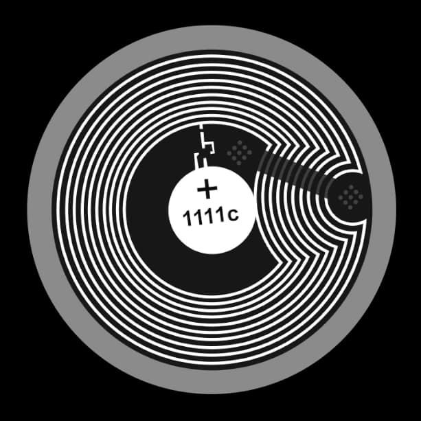

NFC Tag
NFC Tag
Using the affiliate links above helps support the channel and all the content I create 🎉🙌
homeassistant/automations.yaml
alias: Game Mode Tag Scanned
description: ""
mode: single
trigger:
  - platform: tag
    tag_id: 093a435c-df27-4289-8382-9bf75a42ffc2
condition: []
action:
  - service: input_boolean.toggle
    metadata: {}
    data: {}
    target:
      entity_id: input_boolean.iscontrolleroutofplace
