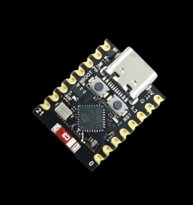

  • ESP32-C3 Development Board
    ESP32-C3 Board
    • Amazon: (3 pack)
    • Aliexpress:
      • TENSTAR
      • Win Win
Got Wi-Fi issues with your board?
The AliExpress and Amazon links on our site are for vendors whose versions of the board are reported by users to have
proper Wi-Fi antenna isolation
If you're still having trouble connecting after flashing, give the firmware with the Wi-Fi Fix a try!

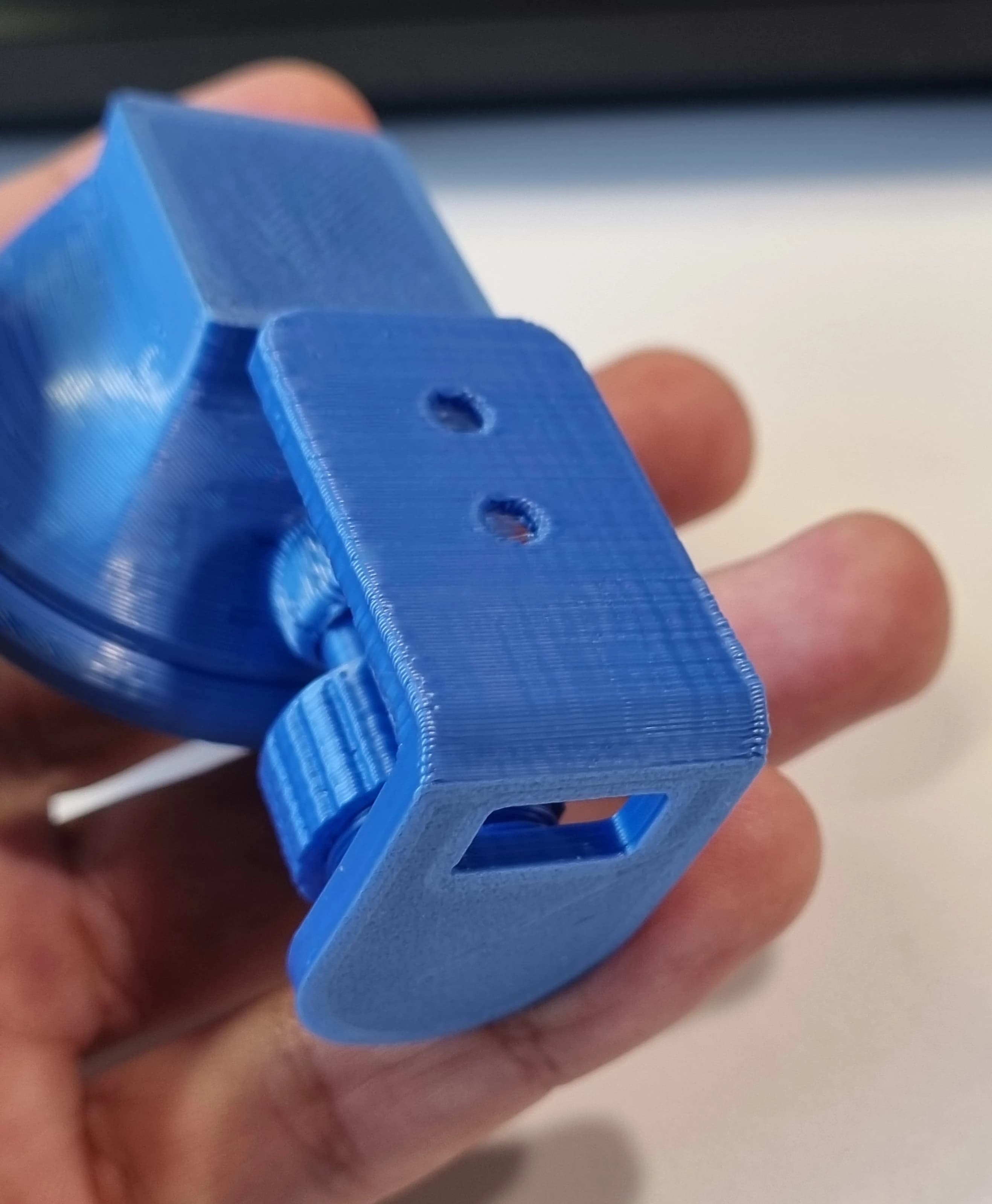

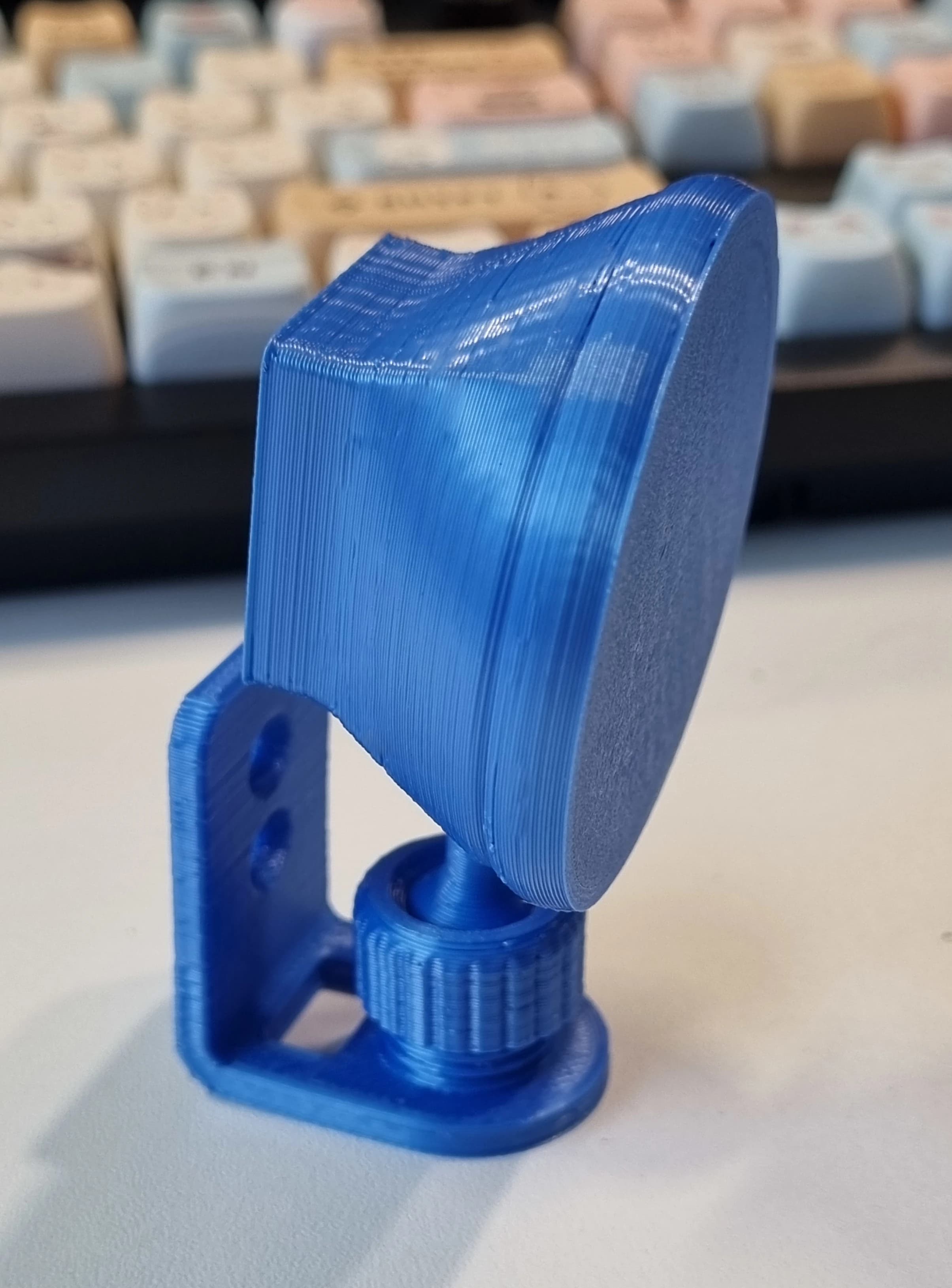

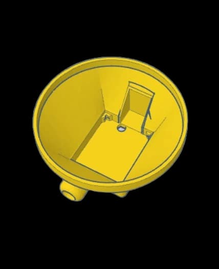

Esp32 C3 mini + LD2450 Sensor Case
By Alejandro Esteban Flores MuÃąoz
You can get it on:

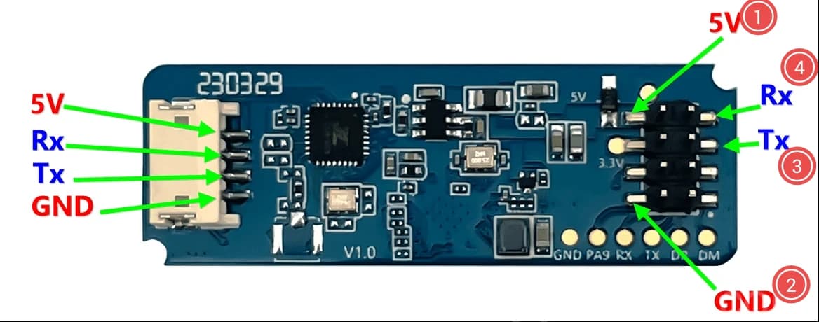

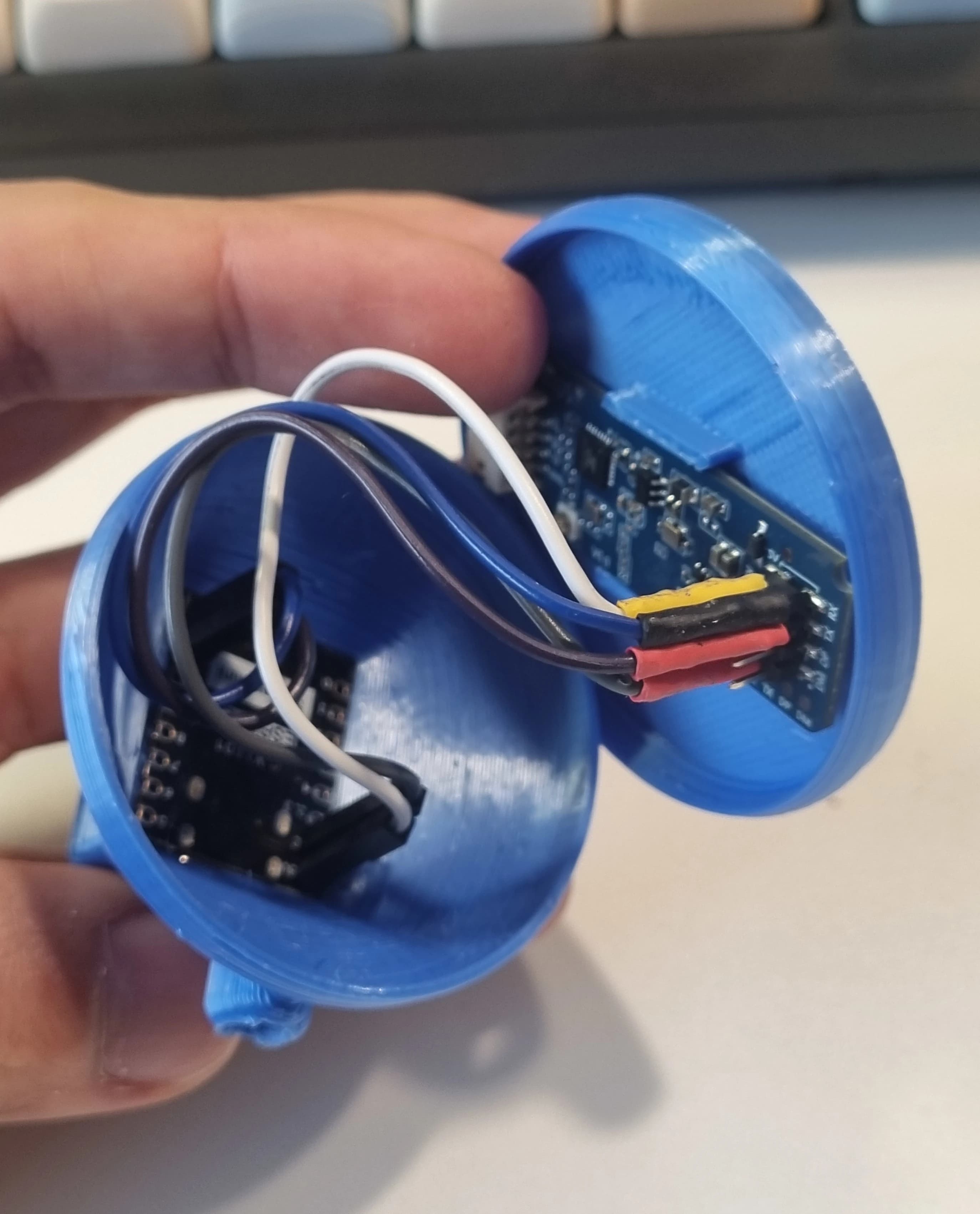

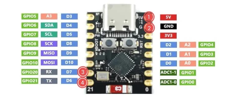

How to wire it up
Wire Up
Wire Up
ESP32-C3 BoardLD2450
5v5v
21 (TX)RX
20 (RX)TX
GGND

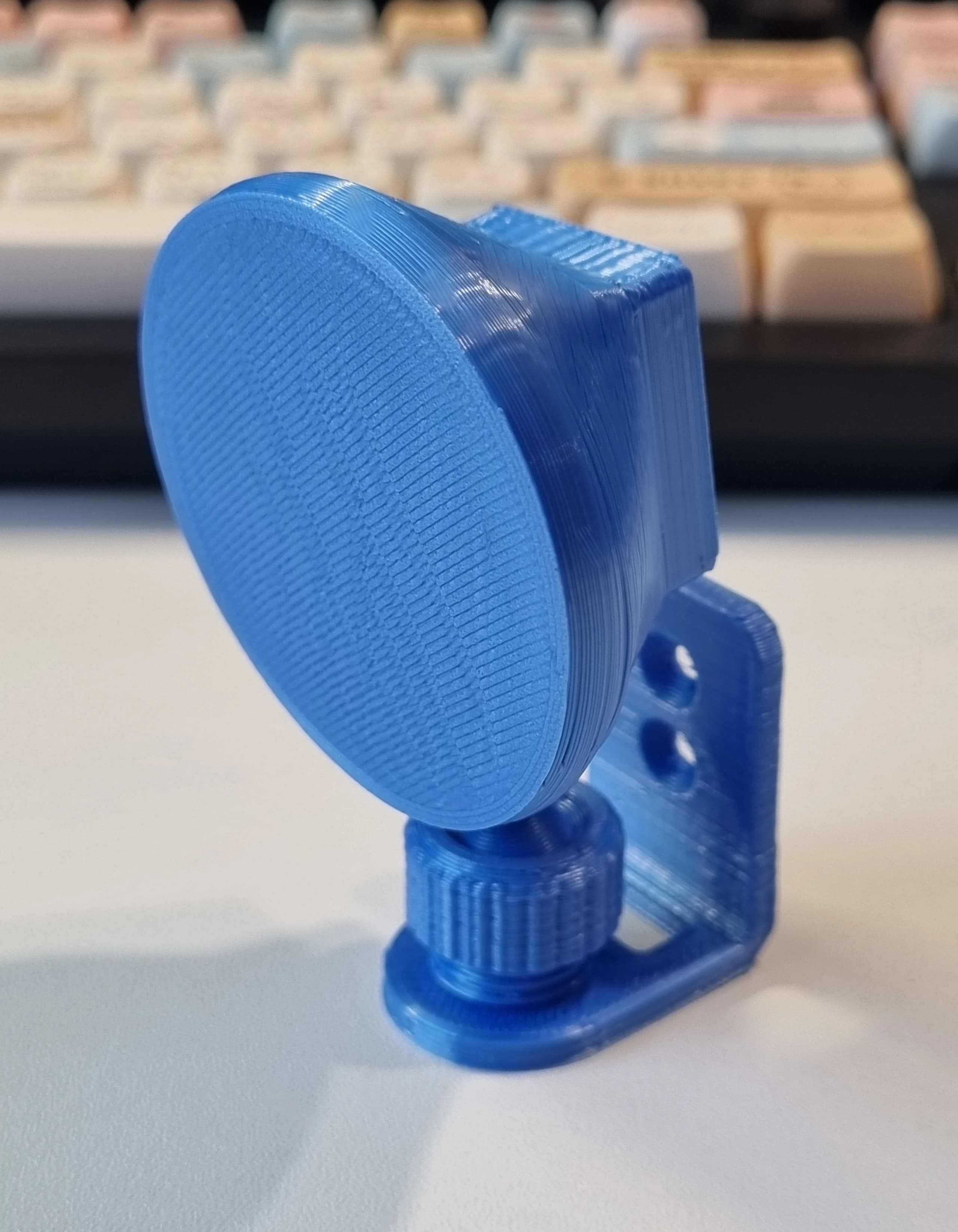

ESP32 C3 Case Housing (Antenna Fix)
ESP32-C3 Case Housing
You can get it on:
