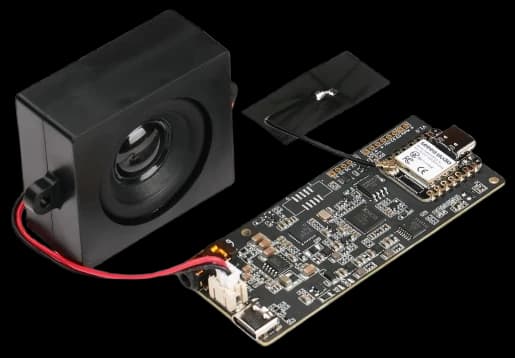

ReSpeaker Lite
Voice Assistant
ReSpeaker Lite Voice Assistant Dev Kit
Microphones2x MEMS Array
ProcessorXMOS XU316 DSP
ConnectionUSB, I2S, GPIO
FeaturesNoise Suppression, Echo Cancellation, 48kHz Audio
IntegrationESPHome, Home Assistant

ATTENTION! This step is now mandatory: Solder USR to D2 and MUTE to D3 pins
Flash XU316 48Khz Firmware
Follow DFU Util installation instructions on Seeed Studio Wiki
Download the XU316 firmware from the GitHub Repo
Flash XU316 firmware
dfu-util -R -e -a 1 -D
Flash ESPHome VOICE PE Firmware
Includes SoundSense for Sound Presence Detection and Dynamic Volume Control
You can grab the YAML file from the GitHub Repo

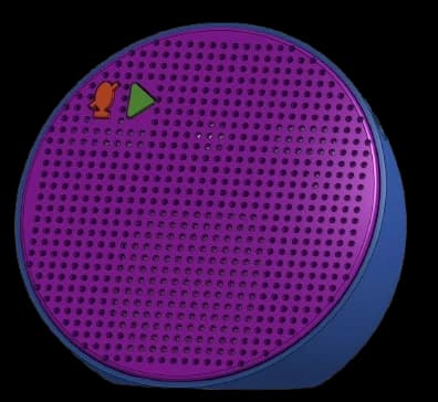

Case for 3D printing
respeaker lite case
You can find assembly instructions here
