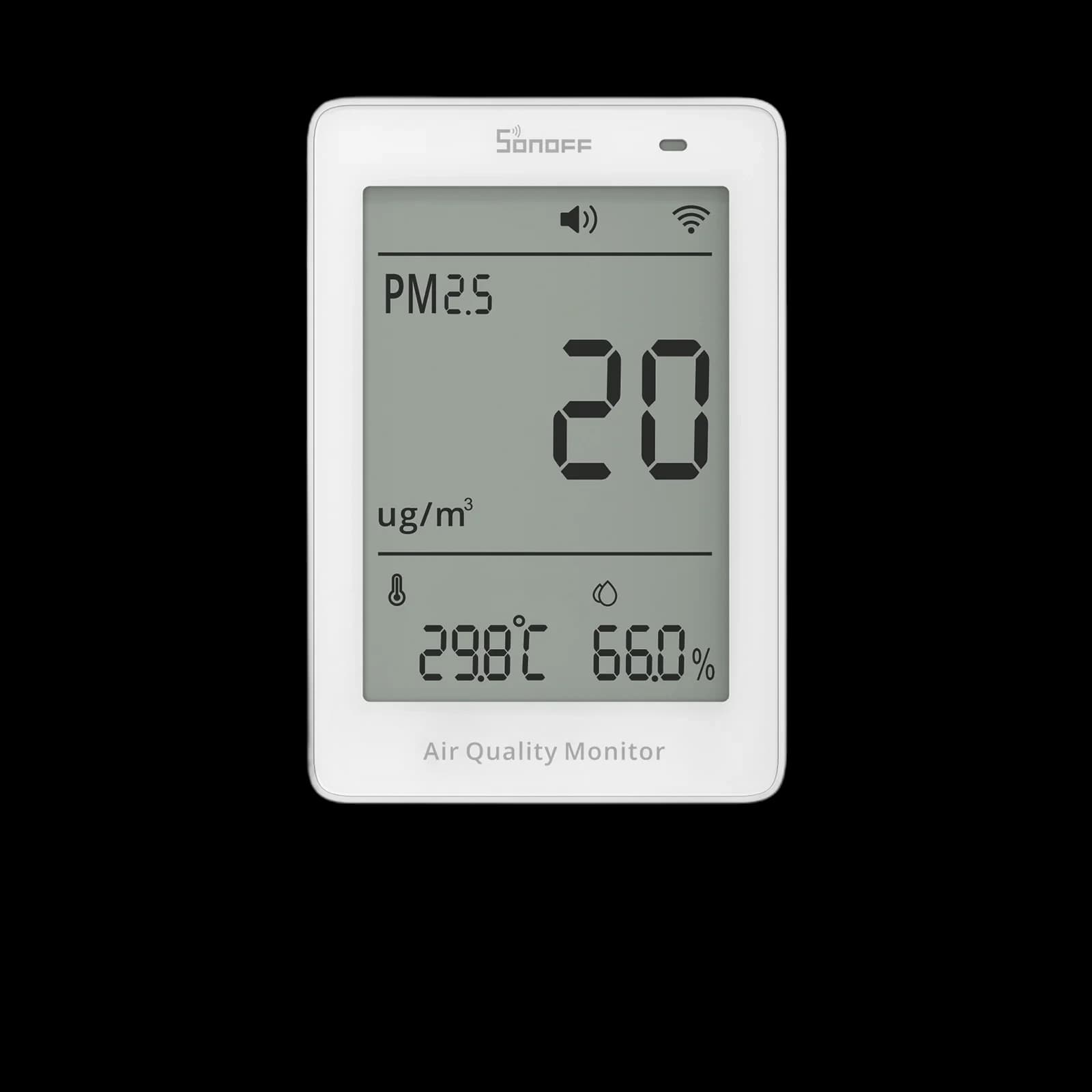

SONOFF AirGuard PM2.5
Air Quality Monitor
ModelSAWF-07P
ConnectivityWi-Fi 2.4GHz + Matter
Accuracy±10μg/m³ (0-100μg/m³)
Update RateEvery 2 seconds
Temp Range-10℃~50℃
Humidity Range5-95%RH
Dimensions70x103x26mm
Weight127.6g
The SONOFF AirGuard PM2.5 is the first PM2.5 & PM10 monitor with native Matter support, making it incredibly easy to integrate with Apple Home, Google Home, and Home Assistant. It features a high-definition LCD screen that displays real-time PM2.5, PM10, temperature, and humidity data.
Key Features
  • High Accuracy: ±10μg/m³ (0-100μg/m³) and ±10% (100-500μg/m³)
  • Fast Response: Measurements every 2 seconds
  • Triple-Alert System: Sound, colored light indicator, and app notifications
  • Matter Compatible: Seamless integration with major smart home platforms
  • Year-Long Data Tracking: 12 months of historical data with export capability

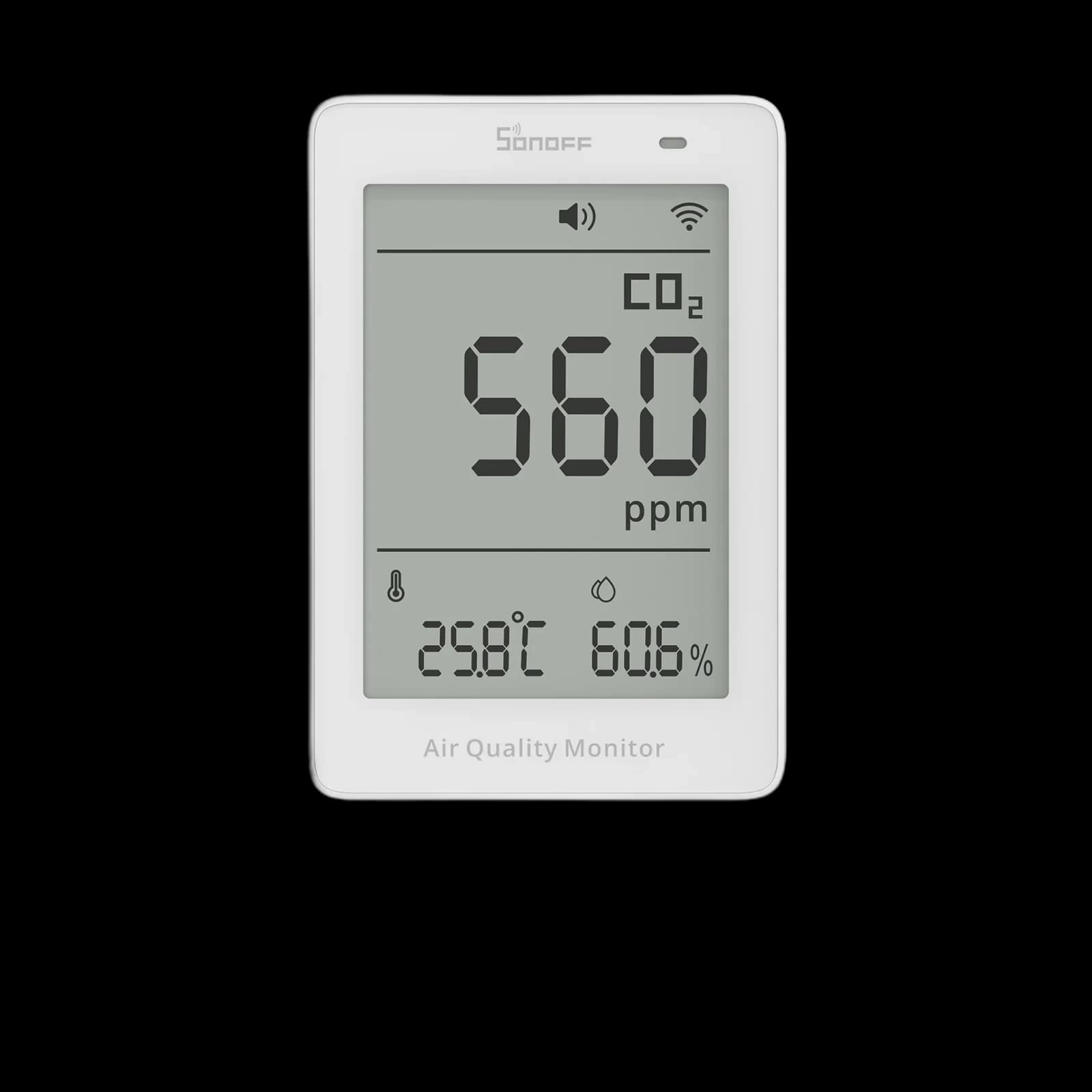

SONOFF AirGuard CO2
CO2 Monitor
SONOFF AirGuard CO2
ModelSAWF-08P
Accuracy±(50ppm + 5%)
Update RateEvery 5 seconds
Temp Range-10℃~50℃
Weight101g
The SONOFF AirGuard CO2 is the first CO₂ monitor in the market with native Matter-Ecosystem support. It provides accurate CO₂ concentration monitoring along with temperature and humidity tracking, perfect for maintaining optimal indoor air quality.
Key Features
  • High Accuracy: ±(50ppm + 5%) accuracy
  • Quick Updates: Readings every 5 seconds
  • 3-in-1 Display: CO₂, temperature, and humidity on one screen
  • Triple-Alert System: Customizable sound, light, and app alerts with Do Not Disturb mode
  • Voice Control: Check CO₂ levels via Alexa or Google Assistant

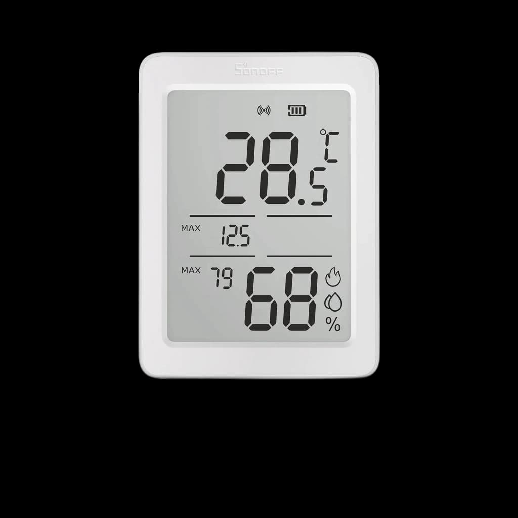

SONOFF AirGuard TH
Temperature & Humidity Sensor
SONOFF AirGuard TH
ModelSNZB-02DR2
ConnectivityZigbee 3.0 + Bluetooth
Display3.6'' LCD Screen
Temp Tolerance±0.2℃/±0.36℉
Humidity Tolerance±2%RH
Power2x AAA Battery
Dimensions95x70x18.2mm
Weight99.3g (with batteries)
The SONOFF AirGuard TH is a versatile Zigbee 3.0 temperature and humidity sensor with a large 3.6" LCD display. It features both Zigbee and Bluetooth connectivity, offering flexibility in how you monitor your environment.
Key Features
  • Large 3.6" Display: Shows local and remote readings plus 24-hour extremes
  • Dual Connectivity: Zigbee 3.0 or Bluetooth options
  • Advanced Analytics: Dew point and VPD tracking with historical trends
  • Dual-Location Comparison: Compare two locations on one screen
  • 6-Month History: Detailed historical data with charts and graphs
