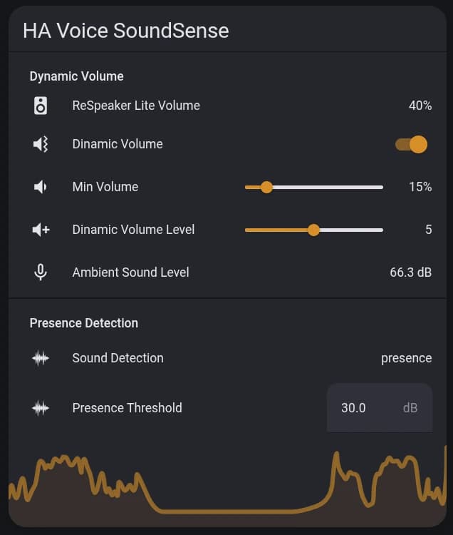

Sound Detection States
  • Silence: Prolonged period (>15s) of very low ambient noise
  • Quieting: Recent transition to low ambient noise
  • Active: Normal ambient sound activity
  • Noise: Sudden spikes in sound levels
  • Presence: Sustained elevated sound levels, indicating ongoing activity or presence
How to add it to your device
You can find the documentation here
ESPHome package
packages:
  SoundSense: github://fixtse/ha-voice-sound-sense/sound_sense.yaml
microphone:
  - platform: i2s_audio  # or your microphone platform
    # ... your existing microphone config ...
    on_data:
      - script.execute:
          audio_data: !lambda return x;
The package is already included in my ReSpeaker Lite Firmware
